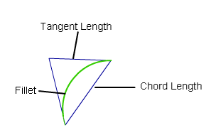

  3. In the control window, set Chordal Type to Chordal length and Chordal Length to the initial chord length for the fillet.

  5. If you want to specify the tangent length for all manipulators, instead of the chordal length, set Chordal Type to Tangent length.
    The appearance of the manipulator changes slightly. The Chordal Length field in the control window becomes Tangent Length.
