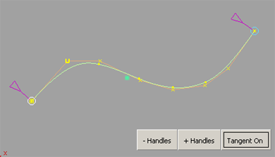

How do I use the curve stretch handles?
- To change the number of handles, press the - Handles or + Handles buttons. The minimum number of handles is 2. The maximum number is equal to the curve’s degree + 1. For example, a degree 3 curve cannot have more than 4 handles.
- To change a handle’s location along the curve, click and drag the purple triangle attached to it.

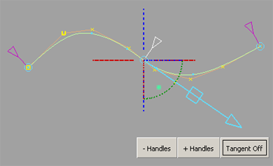

How do I use the tangent manipulator?
- Press the Tangent On button to bring up the manipulator on the active handle.
- Use the manipulator’s arrow head to modify the position of the curve at that point by sliding it along the tangent.
- Use the manipulator’s square to scale the tangent.
- Use the manipulator’s dotted arcs to rotate the tangent around the X, Y or Z axes.
- Use the manipulator’s axes lines to orient the tangent along the X, Y or Z axes.
- Press the Tangent Off button to remove the manipulator.

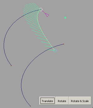

Method 1: Translating and Rotating a curve (rocking)
- Choose Curve Edit > Modify > Transform Curve
- Select the curve.
Two control handles (circles) appear at the start and end points of the selected curve.
Note:
You can move the control handles along the curve by clicking on them and dragging the small purple arrow along the curve.
- Click on the Translate button in the window.
- Select the control handle closest to the first rail.
The selected handle turns white.
- Turn on Curve snap mode by holding down the
and
(Windows) or
and
(Mac) keys (or Magnet mode by holding down
(Windows) or
(Mac) only).
- Click on the first rail curve. Drag to change the position of the intersection.
The input curve is translated so that the first control handle intersects the first rail.

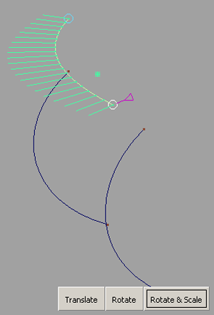

Method 2: Rotating and Scaling a curve (dilating)
- Select the curve.
Note:
- Click on the Rotate & Scale button in the window.
- Click on one control handle.
and
(Windows) or
and
(Windows) or
(Mac) only).

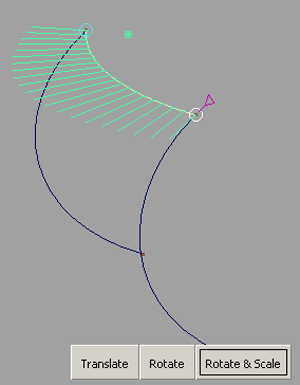

- Click on the rail curve you want to snap the selected handle to.
- Repeat steps 4 to 6 with the other control handle.
The input curve is scaled so that both control handles make contact with the target points on the rail curves.
The curve is modified, but the general shape characteristics are maintained, as can be verified by using a curvature comb on the curve (Locators > Curve Curvature

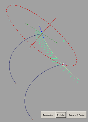

How do I use the rotation manipulator?
The rotation manipulator appears when you are in Rotate mode (Rotate button depressed). It has three axes (X, Y and Z), and a circle along which the selected handle on the curve rotates. By default, this circle is drawn in the plane of the curve.
