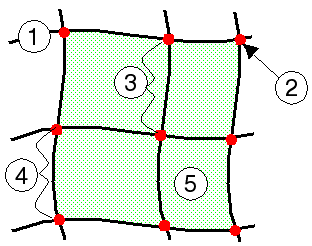

Refer to the diagram at left for illustrations of the following terms used with curve networks:
- Curve: one of the curves in the network.
- Intersection: where two curves in the network cross at the exact same point in space. In the interface this is also called a vertex.
- Curve segment: a section of a curve defined by intersections (vertices) at both ends. Many of the curve network tools work on curve segments, including the continuity tools. In the interface, and sometimes in this chapter, this is called an edge.
- Region: closed area of a curve network bounded by either three or four curve segments (edges).
- Curve network surfaces: the surfaces are distinct from the curve network itself. In fact, the surface can be pulled away from the network by sculpt curves.
- Curve network: all the curves defining the surfaces. Alias will not build surfaces until all the curves in the network are valid.

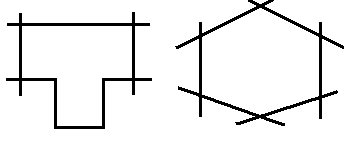

The following regions are not valid
- Regions with more than five sides.

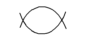

- Regions with only two sides.
- Regions with T-junctions that cannot be “collapsed” into three, four, or five sided regions.

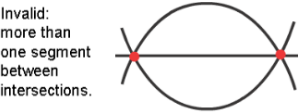

- There can be only one curve segment between any two intersections.
