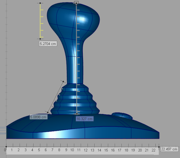

How to quickly measure distances on shaded models using Evaluate > Dynamic Measurement. This tool also works on wireframe models.
To create a dynamic measurement
A cross-hair appears.
A ruler appears between the two points and the distance between the points is displayed (in the current linear units).
Click with the middle or right mouse button, to align the second point horizontally or vertically (respectively) with the first point.
The measurements are not persistent and disappear as soon as you select another tool.
To modify the start and end points of a dynamic measurement
The point turns yellow.
To move the measurement
The ruler turns yellow.
To anchor a measurement
The start point turns into a square to indicate that it is attached to the object. The ruler becomes lavender and remains parallel to the view plane.
A measurement can be anchored in any view, including the Perspective view.
To remove all measurements
All measurements disappear as soon as you choose another tool. However, if you need to remove them while still in the Dynamic Measurement tool, press the Clear button at the bottom of the window.
