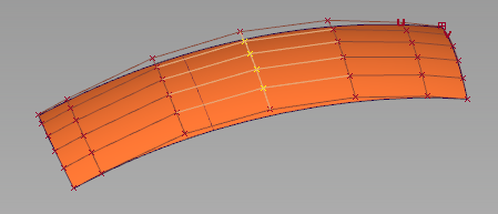

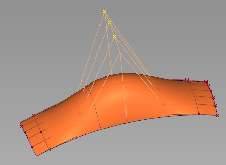

  4. Drag a mouse button to move the CVs:
    • Drag the to move along the normal.
    • Drag the to move along the U direction.
    • Drag the to move along the V direction of a surface.
    Moving four CVs along the surface normals.

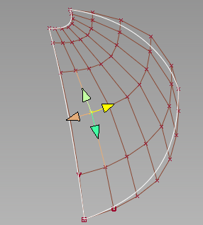

  3. Click the CV you want to move. To select additional CVs, hold and click them.
  4. Click the arrow on the hull you want to move the CVs along, then drag to move the CVs.
