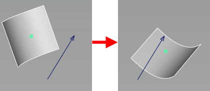

Rotate around a vector
- Choose Transform > Rotate
and select Vector.
- Create the vector by clicking in the view where you want the vector to start or typing the start position in the prompt line.
- Adjust the manipulator to position the vector and click Accept.
- Enter a sweep angle on the prompt line.
