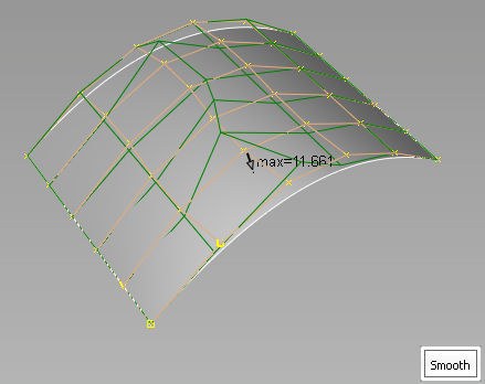

The Smooth tool harmonizes CV distances and simultaneously minimizes angles/kinks inside the hulls of a selected curve or surface.
For surfaces, you can choose to smooth only in the U or V direction.
While smoothing, you can display a proxy representing the original curve or surface (green) and you can display feedback indicating the maximum deviation between the original surface and the smoothed surface (orange).
Smooth a curve or surface
  1. Choose Obect Edit > Smooth .
  2. Select the surface or curve to smooth. The Smooth button appears.
  3. To smooth a surface in the U or V direction only, check on U or V in the control window.
  4. To keep the edges of the surface fixed so the CVs do not move during the smoothing operation, turn on Fixed edges. You cannot change this setting after the first smoothing has been applied.
  5. Click the Smooth button or press the spacebar to smooth the selected object.
    The change between the input and smoothed object displays and updates.
