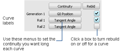

In the option window of the tool you used to create a surface, use the pop-up menus next to the names of the generation and rail curves to choose what level of continuity the surface should maintain with its neighbor along that edge.

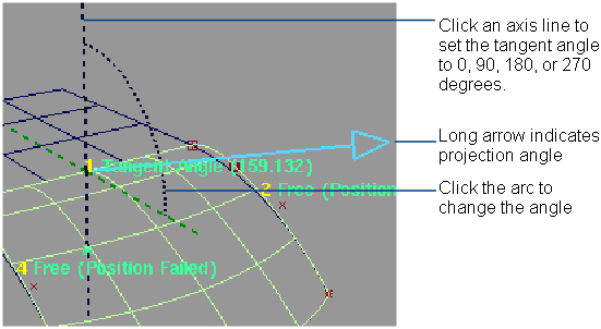

Set a manual tangent angle along an edge
- In the option window, set the continuity for the edge to Tangent Angle.
- Use the tangent angle manipulator to set the angle.
How do I use the tangent angle manipulator?
- Click an axis line to set the tangent angle to 0, 90, 180, or 270 degrees.
- Click an arc, then drag left and right to change the angle value, or type a number to set the value exactly.
- When you are finished, click Go.

- Turn on the Rebuild check box for the edge. This allows the tool to change the geometry of the edge as it attempts to achieve continuity.
