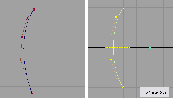

    If the curve is not already symmetric, the tool modifies the controls to make it symmetric. The position of the controls from the beginning of the curve are applied to the symmetric partners at the end of the curve. Click the Flip Master Side button to have it work the other way around.

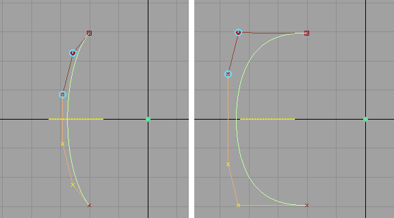

  3. Pick one or more CVs on one side of the curve.
    Blue circles appear around the corresponding CVs on the symmetric half.
  4. Move the CVs. You can use any transformation tool, such as Transform > Move or Control Panel > Transform CV.
    • The selected CVs follow the mouse. The symmetric CVs move in the opposite direction on the symmetric side of the plane.

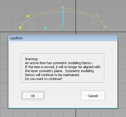

    • If you move the curve, the symmetry plane moves with it but is drawn in a different color to differentiate the curve from symmetric objects still aligned to the layer symmetry plane. A confirm box warns you. Clicking Cancel undoes the transformation.
