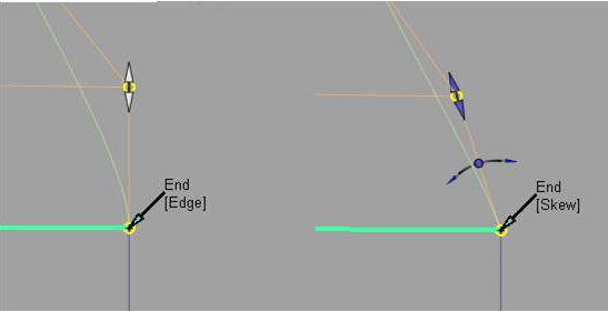

  6. Change the outside edge alignment by clicking the Edge label to toggle between Skew or Edge Align. Or set Start Align and End Align in the Outer Edge section of the option window.
    When Skew is selected, a rotational manipulator becomes visible which allows direct modification of the skew angle. You can also specify a specific Skew Angle value in the option window.
    When Edge Align is selected and you are aligning to a natural surface boundary, you can turn on Tangent Balance to adjust the CVs on the tangent row so that the tangent lengths of the Input surface match those of the Master. The same applies to the curvature row CVs if G2 Curvature is on, and to the next row of CVs if G3 Curvature is on.

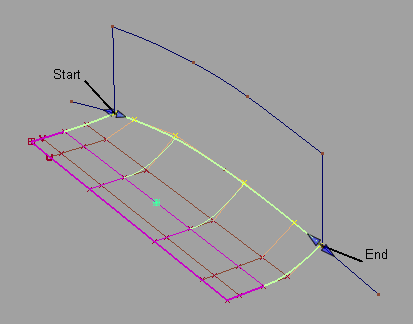

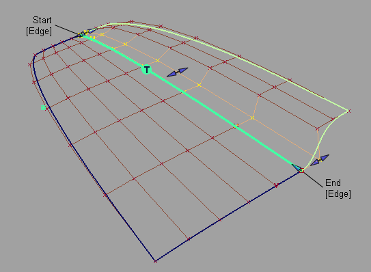

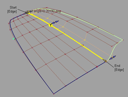

Partially align two surfaces
  1. Choose Object Edit > Align > Align .
  2. Click the Partial checkbox in the option window to turn it on.
  3. Click the edge of the surface you want to align.
  4. Click the edge of the surface you are aligning to (Master).
    The first surface is aligned to the closest points on the second surface.

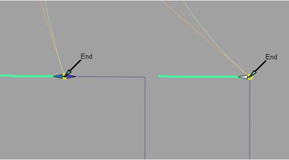

  5. Modify the location of the endpoints with the Partial manipulators.
    The Partial manipulators will change from a double sided arrow to a single arrow when they snap to the end of the Master surface.
    You can also use the Start and End sliders in the option window.

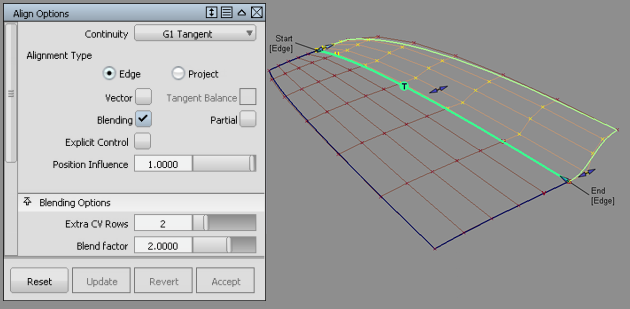

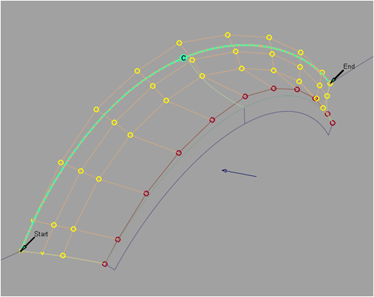

Blend an alignment
    Blending extends the influence of the blend further into the surface or curve.
  1. After an alignment has been created, click the Blending checkbox in the option window, to turn blending on.
  2. Select how many Extra CV Rows the blend will apply to.
  3. Modify the Blend factor to provide more or less influence from the original alignment type.
    Two rows beyond the tangent row are affected by the Blend factor.
Note:
Blending can be applied to a positional alignment as well to create a smooth distribution of CVs from the alignment edge.

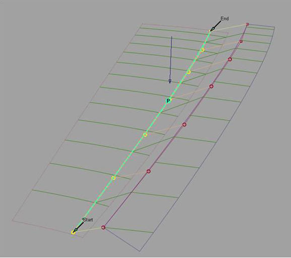

Align by projecting an edge onto a surface (Projection alignment)
    A surface can be aligned to the inside of another surface by projecting the edge along a vector down to the Master surface
  2. Set the Alignment Type to Project in the option window.
  3. Select the edge to align.
    The Vector Options section appears.
  4. Do one of the following:
    • Choose X,Y, or Z as the vector direction
    • Choose Picked and select an existing vector
    • Choose View to use the direction of the current view as the vector direction
    • Choose Normal to use the Master surface's normals as the projection direction, instead of using a single vector.
  5. Select the surface to align to (Master).
    The edge is projected along the defined vector onto the Master surface. A curve-on-surface is created as well, and can be used later for trimming the Master surface.

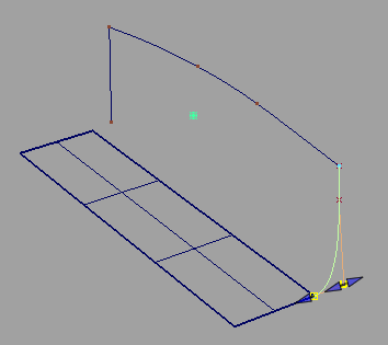

Align a curve end to a surface edge, isoparm, or curve-on-surface
    This aligns the end of the curve to the end of the surface curve.
  2. Click the curve close to the end you want to align. Click the surface edge, isoparametric curve, or curve-on-surface at the point you wish to align to.
  3. Set Continuity to G1 Tangent, G2 Curvature, or G3 Curvature if desired.
    The Alignment Type option becomes available. U/V is the default and aligns the free curve to the direction of the surface curve that you selected as the Master.
  4. Set Alignment Type to Vector if you want to align a curve to the interior of a surface, without the need for a curve-on-surface.
    The tangent and curvature alignment are then defined by the tangent plane to the surface at the point of contact, and the direction of the vector specified through Vector Options
    Alignment Type = Vector: This is equivalent to creating a curve-on-surface on the surface, and aligning the free curve to it.

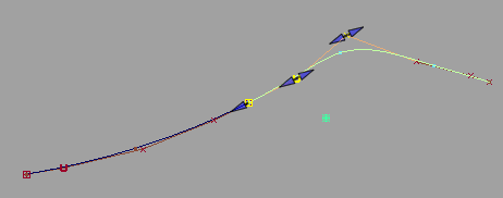

  4. Set the continuity level by selecting G0 Position, G1 Tangent, G2 Curvature, or G3 Curvature in the Continuity section of the option window.

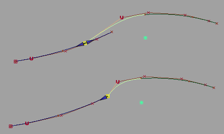

    Manipulator arrows become available, allowing direct manipulation of the attach point location, as well as tangent and curvature scaling.
  5. Modify the location of the Attach Point, Tangent Scale, Curvature Scale, or G3 Scale with the manipulators, or control window sliders.
Aligning curves with positional continuity and modifying the Attach Point.
Aligning curves with G2 curvature continuity.

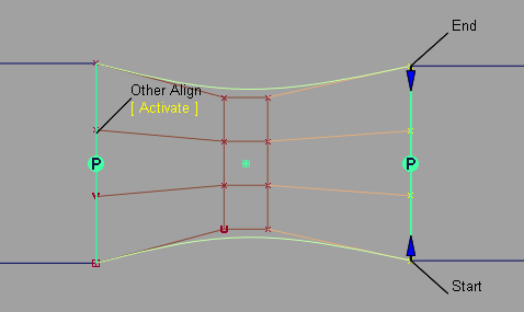

Align both ends of a curve or surface
