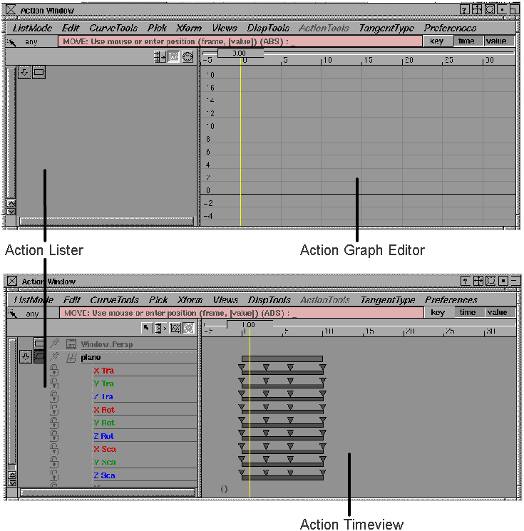

Action window interface
Choose Animation > Editors > Action Window to open the Action Window. The Action Window has three components:
The Action Lister is always displayed on the left side of the Action Window.
On the right side, you can display either the graph editor or the timeview. Use one of the icons in the Lister title bar to switch between these two views.
The Action Window also has its own set of pull-down menus. See Action Window menus on Action Window menus for information.
There is a prompt line below the menus. It displays error message information and prompts you for input that is required when you select certain menus. When the prompt line is dark pink and the cursor is not in the Action Window, you know that the window is not active. The cursor must be in the Action Window in order for keyboard input to be recognized. The prompt line also contains snap toggles (see Action window snap toggles) that help you constrain movement.

Action Lister
The Action Lister lists items with their channels and is always displayed on the left hand side of the Action window. The contents of the Lister depends on the settings of the List Mode menu. Objects and channels that have an animation associated with them are displayed in a dark color, while entries without an animation appear in a lighter color.
Parameters that have an expression attached to them also appear in a dark color, with a pair of brackets () next to the parameter name (if Disp Tools > Show curve names is enabled in the Action Window, the expression appears within the brackets).
Channels animated by a single action may also have the name of the action curve displayed next to the parameter name.

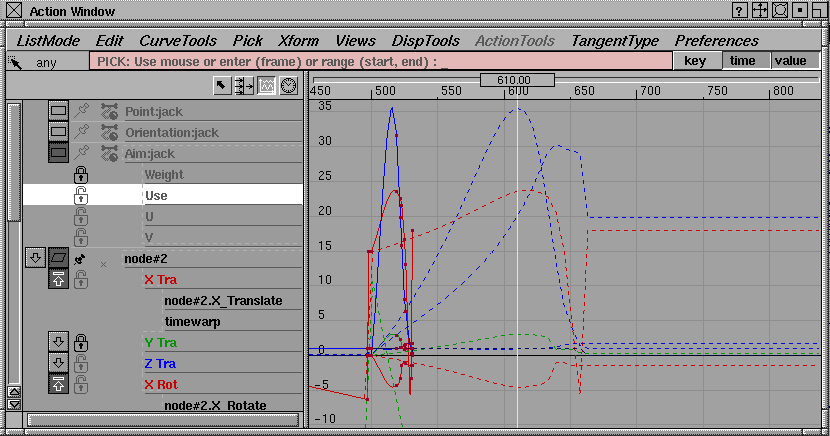

Action graph editor
Note:
View the graph editor with this icon.
Use the graph editor to create and modify actions. There are also a few operations that you can apply to channels.
The curves in the graph editor reflect what is in the Action Lister. For example, if an item has three parameters that are animated each by a single curve channel, then three actions are displayed in the graph editor.
If a channel has two or more actions on it (for example, a base action and timing curves, which were created using Set motion), the channel appears in the Lister with an expand channel button. When you click this button, the channel’s animation curves are added to the Lister and to the graph editor. If the channel is not expanded, only the resulting animation curve on the channel is displayed in the graph editor.
The resulting curve (result curve) is the final evaluation of the channel with all of its actions. Result curves are always displayed as dashed lines because they are not editable. You can toggle their display on or off by choosing Tgl result curves from the Disp Tools menu in the Action Window.
You can pick channels and animation curves in the graph editor by selecting the name of the animation parameter in the Action Lister.

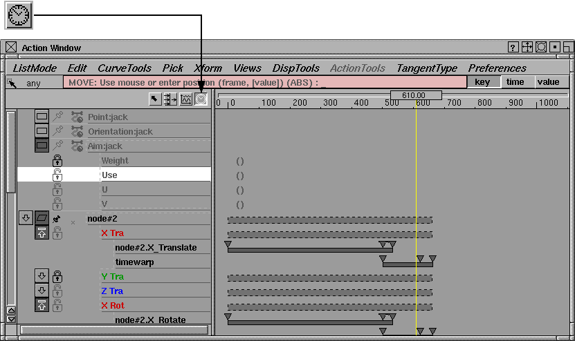

Action timeview
View the timeview with the following icon:
The timeview is an alternate way of viewing actions and channels. You see only the duration of actions without the animation curves that appear in the graph editor. The timeview is useful if you are satisfied with your animation’s motion but want to adjust its timing. You can edit individual actions, single channels of an animatable item, or channels for the whole animatable item. You can also use this view to coordinate the movement of objects in your scene.

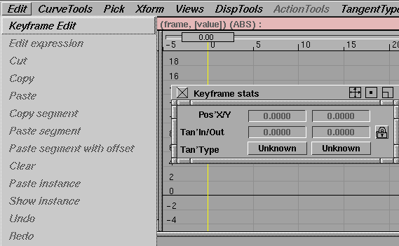

Keyframe Edit
Opens up the Keyframe Stats window which can be used to edit the frame, value, and tangents of individual keyframes.

Viewing and editing keyframe stats
Choose Keyframe Edit to open the Keyframe stats window, which lets you view and edit frame, value and tangent information for one or more keyframes, one keyframe at a time.
Once the Keyframe Stats window is opened, pick a keyframe in the Action window. Each time you pick a keyframe, the Keyframe Stats window shows the information for the picked keyframe.
The parameters in the Keyframe Stats window are described below.
Pos’ X/Y
The current position of the keyframe. The first number is the frame time of the keyframe and the second number is the value of the keyframe. You can change the position of the keyframe by clicking a number and entering a new number.
Note:
You can not enter a time that is outside the segment in which the keyframe is contained.
Tan’ In/Out
The angles of the in-tangents and out-tangents on the keyframe. The values must be between -90.0 and 90.0. If you change the value of either of these tangents, the tangent type for that tangent becomes fixed. This ensures that the new tangent value that you assigned to the keyframe retains that value.
Tangent Lock Button
Next to the tangent values is a tangent lock button. Clicking this button locks in the current angle between the in-tangents and out-tangents, so that if you modify one of them, the other is modified by a compensating amount.
For example, if the in-tangent is 10 degrees and the out-tangent is 30 degrees, then the angle between them is (90 - 30) + (90 - 10) = 140 degrees. It you turn on tangent lock and change the out-tangent value to -20 degrees (a decrease of 30), the in-tangent value changes to 60 degrees (an increase of 30), thereby maintaining the 140 degree angle between them.
Note:
The tangent lock button works only for changes in the Keyframe Stats window. To maintain a tangent relationship when changing tangents using Transform > Move, use the .
Tan’ Type
For more information on tangent types, see the description of the Tangent types.
Shows the current type of the in- and out-tangents. The tangent type controls how tangents are recomputed when a keyframe is moved or when keyframes are added or deleted next to the keyframe. Click down on the currently displayed tangent type to use a menu to select a different tangent type. (The current tangent type is highlighted in the menu.)
Notes on selecting multiple keyframes
When you have the keyframe stats window open, you can also select multiple keyframes. If any of the position or tangent values are the same for all picked keyframes, the corresponding value is shown in black.
If the values are not all the same, the value in the keyframe stats window is gray. If you select this value and enter a new value, and then all picked keyframes assume this same value.
For example, if you pick two keyframes, one with a value of 5 and the other has a value of 10, then the keyframe stats show the value of one of the keyframes in gray, indicating that not all picked keyframes have the same value. If you select this grayed value and type in 7, now both keyframes are given a value of 7 (and it is displayed in black).
If multiple keyframes are picked and they all have the same tangent type, then this tangent type is displayed. If not all keyframes have the same tangent type, then the Tan’ Type parameter says Unknown. You can select an Unknown tangent type and select another tangent type; then all keyframes assume this same tangent type.
(Tangent angles and tangent types can also be copied from one keyframe to another using Edit > Copy and Edit > Paste.)

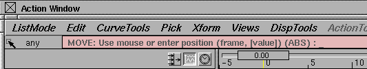

Move
Lets you move keyframes, tangents, or the whole curve.
To use Move, select any number of components using Pick and then choose Move. Drag the cursor in the graph editor window. The picked objects follow the cursor.
When moving keyframes and curves:
  • The moves objects in both the horizontal and vertical directions.
  • The constrains movement horizontally.
  • The constrains movement vertically.
When moving tangents:
  • The moves without constraints. Note, however, that the in-tangent stays to the left of the keyframe and the out-tangent stays to the right of the keyframe.
  • The locks the in-tangents and out-tangents of a keyframe so that they remain 180 degrees apart (that is, in a straight line). This ensures that the curve is smooth through the keyframe.
  • The locks the in-tangents and out-tangents of a keyframe so that they maintain the current angle between them.
Normally, when you are moving tangents, horizontal motion of the mouse is ignored and the tangents move proportionally to the vertical motion of the mouse. So, if the mouse moves one quarter of the way up the Action Window, all the selected tangents move up by 45 degrees, which is one quarter of their total range of movement.
If you hold down the (Windows) or (Mac) key while moving tangents, instead of proportional movement you get direct movement, where the tangents point directly at the current position of the selection arrow:
  • The causes all active tangents to immediately change position so that they point directly at the selection arrow.
    If a tangent is on the opposite side of its keyframe from the selection arrow, it cannot point directly at the pointer and instead is pinned to point straight up if the pointer is higher than the keyframe or straight down if the pointer is lower than the keyframe. For this reason it is typically not very useful to use this form of tangent movement when both in-tangents and out-tangents are selected at the same keyframe.
  • The locks the in-tangents and the out-tangents of a keyframe so they remain 180 degrees apart (that is, in a straight line), then moves the nearest of each tangent pair so that it points directly at the selection arrow. Nearest means the tangent that is on the same side of the keyframe as the selection arrow. For example, if the selection arrow is to the left of a keyframe, its in-tangent points directly at the pointer and the out-tangent points directly away. If the selection arrow then moves to the right of that keyframe, the tangents reverse roles, with the out-tangent pointing at the selection arrow and the in-tangent pointing away.
  • The locks the in-tangents and out-tangents so that they maintain the current angle between them. The nearest tangent of each pair (that is, the one on the same side of the keyframe as the selection arrow) is then moved to point directly at the selection arrow, to the degree that the fixed angle between the two tangents allows.
    Note:
    When you move a tangent its type changes to fixed.
Using keyboard input to move objects
You can use keyboard input to specify where to move curves or keyframes, and to give tangent values. If you precede your keyboard input with A, the values entered are interpreted as the absolute position to move to. If you precede your keyboard input with R, the values entered are interpreted relative to their current values.
For example, typing A 10 5 moves a keyframe to the time 10, and value 5. If you then type R 2 1, the keyframe is placed at time 12 and value 6. You can enter either positive or negative numbers.
If a curve is picked, Move moves the whole curve with respect to the first keyframe on the curve.
If a tangent is picked, only one value needs to be entered at the keyboard. This value is an angle between -90 and 90 degrees. An angle of 0 degrees means the tangent is horizontal. You cannot assign a value of exactly -90 or 90 to a tangent because this would produce a vertical line in the curve; however, you can assign tangent values close to -90 or 90.

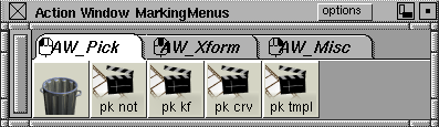

Edit marking menus
Let you customize a marking menu shelf.
To display an Action window marking menu
  1. Press and hold and (Windows) or and (Mac) simultaneously.
  2. Click and hold a mouse button anywhere in the Action Window.
  3. To select a command, drag in the direction of the command. As you drag, a rubber band line is drawn from the center of the menu that follows the cursor.
To edit a marking menu
  1. Choose Preferences > Edit Marking Menus. A shelf window for the current tools in the marking menu appears:
  2. To change the items used in a marking menu, modify the contents of folders by dragging and dropping the appropriate tools.
    To delete an individual tool, click and drag the tool with the into the trash can. To delete a folder, click the folder tab with the and drag it into the trash can.
To assign mouse buttons
Mouse buttons can be assigned to folders. For example, you might want to assign the to the pick tools folder and the to the Transform tools folder. The mouse icon in the folder tab corner indicates which mouse button the items are assigned to.
