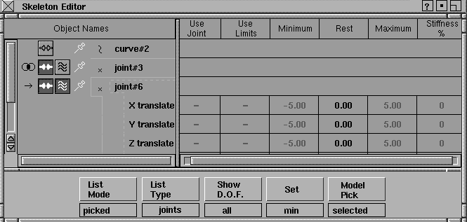

The Skeleton Editor has two sections. On its left side is a lister containing the names of DAG nodes; on the right is a spreadsheet listing the properties of each joint.
The contents of the lister depend on the selection made in List Mode. Each element in the list has up to four icons, plus a DAG node icon and DAG node name.
This toggle changes an existing DAG node to a joint node, or changes an existing joint node to a DAG node. If on, it is dark gray with a white bone joint, which indicates that the DAG node is a joint node. In the SBD window the DAG node has a joint icon drawn in its SBD box. If off, it is light gray instead of dark gray, indicating that the DAG node is not a joint node.
With joint DAG nodes, certain joint properties can be tailored for use with IK handles. These properties are listed on the right side of the Skeleton Editor, in the spreadsheet section.
Click this icon to expand the joint to see the joint components that are used and their joint limits. The expansion state is kept so that the joint is expanded the next time you list it. Click the icon again to collapse the joint.
When you click this icon, the item stays on the list, whether it is picked or not. The icon changes to a black pushed pin.
Double click the DAG node name area to change its name.

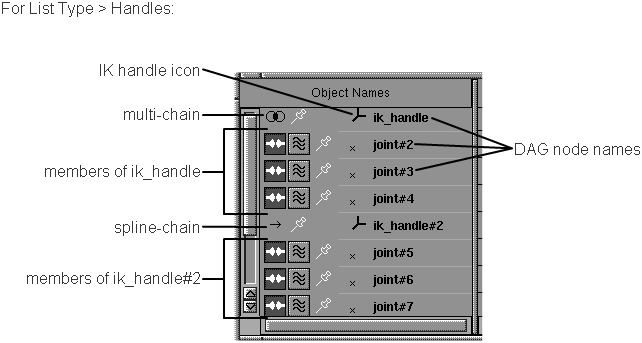

The following icons appear left of the IK handle names to indicate the IK handle controlling type:
The Shared joint icon indicates the joint is shared by both a single-chain and a multi-chain.

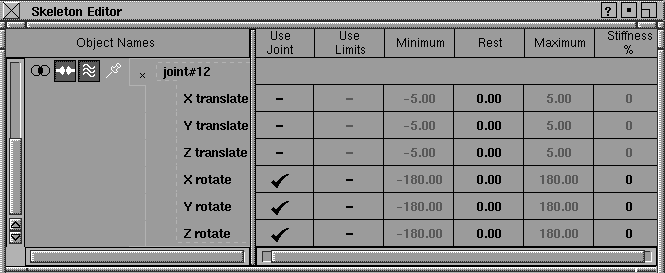

The right side of the Skeleton Editor is a spreadsheet of values that you can edit for different joint node components. (You can edit values only for joints. Before you can edit other objects in this window, you must change them to joints.)
Select the joint expansion icon for one of the joint nodes to see the values for these joints in the spreadsheet. The values for each of the joints in the spreadsheet are used by single-chain or multi-chain IK handles.
This screen shows the Skeleton Editor with the Show D.O.F. menu set to All.
Select Use Joint and Use Limits column entries in the spreadsheet to set them ON (shown by a check mark) or OFF (shown by a dash).
If set to OFF, the parameter does not change during a transformation. This is useful for restricting the motion of a joint. For example, in a skeleton hierarchy of a leg, you may restrict the knee joint so that it can only bend along the x-axis. Therefore, the Y and Z rotations for Use Joint should be OFF.
If set to ON, the joint uses the limits defined in the next two columns, Minimum and Maximum, during transformations. This is useful if you want a joint component to move within a specified joint range. For example, a joint node representing an elbow may have a desired range of 0 to 170 degrees. If Use Limits is ON, and these range limits are set, the elbow joint does not take a value outside that range during a transformation.
If set to OFF, any joint limits set for that joint are ignored. To show this, the Minimum and Maximum cells are grayed out and non-editable.

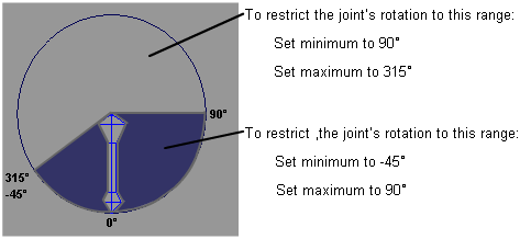

To define limits, see the description of the Set Button in the Set menu section.

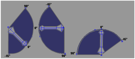

0 degrees is determined with respect to the direction in which you drew the bone originally. If you drew the bone at a slant, the minimum and maximum ranges in the previous example would appear as shown in the following.
These two columns can take any values. The values represent the minimum and maximum values for a joint parameter. For rotation parameters, the values are angles in degrees. For translation parameters, the values are in centimeters. Click in the column on the row of the joint you want to change, and set the minimum or maximum joint value.

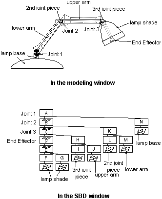

The following example shows a desk lamp and its skeletal hierarchy:
The joints are listed hierarchically.
The joints are listed by IK Handle.

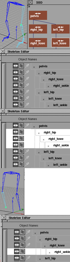

An example best demonstrates how this works. Suppose you have created a two-legged figure:
Since the left knee is not selected in the lister, it is unpicked in the modeling world. Since there is a pick conflict between the joints in the right leg, the lowest joint is selected (right_ankle), and is picked in the modeling world. The other joints in the right leg are unselected in the lister, since they could not be picked in the modeling world.
