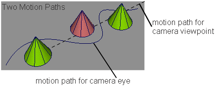

In the next diagram, a second curve has been assigned as the motion path for the camera view. In this case, regardless of the camera position on the eye motion path, the camera’s view is always directed to the cones as it weaves between them.
