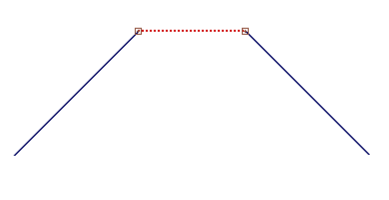

The dashed curve touches the two solid curves, but there is an angle between them and so there is a sharp break between the curves.

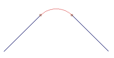

The dashed curve has no angle difference where it meets the solid curves. The Round surface tool and the Curve Fillet tool create this type of continuity.

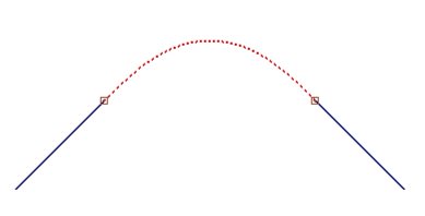

The dashed curve blends in even more smoothly to the solid curves.

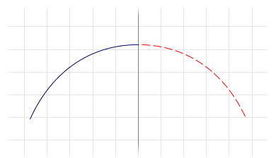

There is one other use of continuity that you will use:
A curve or surface is created on the center line, and will be mirrored. The Implied Tangent tools make sure that the two surfaces (original and mirrored) will be tangent to each other.
