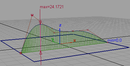

This tool lets you create and change deviation combs. It also displays the minimum, maximum and mean deviation between either a curve and a surface, or a mesh and a surface.
You only see the deviation comb display if both a curve (or mesh) and a surface are selected and Deviation is turned on in the Display section of the Control Panel.
This tool is a combination of Locators > Deviation > Curve to Surface and Locators > Deviation > Mesh to Surface, but provides additional options.
Check or uncheck the Deviation button in the Display options section of the Modeling Panel to display or hide the deviation comb quickly. Hiding the deviation comb reduces the clutter on the screen and improves the interactive performance. To display the comb once more, you do not have to set up the deviation again.
If a surface and a mesh are selected, the Show deviation tool displays the minimum and maximum deviations only.
