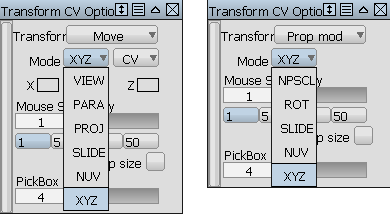

When you double-click the Transform CV icon at the bottom of the Control Panel, the following control window appears.
These options let you move CVs and hulls relative to their curve or surface, in the view plane, along a given vector or reference plane, or in the X, Y, or Z direction. They also let you rotate or scale CVs and hulls with respect to a pivot point, and also move that pivot point.
Finally, they let you move, rotate, or scale CVs by different amounts depending on their proximity to a primary (or master) CV.

Mode – Left Menu
The left mode menu appears only if Transform is set to Move or Prop mod.
The left mode menu controls the action and the right mode menu controls the objects (CVs or Hulls) that the action affects.
XYZ – This mode moves CVs along the X, Y, Z world axes. The mouse buttons operate the same as in the Transform > Move (or Transform > Modify > Proportional mod) tool.
SLIDE – This mode moves CVs along their respective hull. For Prop mod, the arrows only appear around the primary CV.
NUV – This mode moves CVs along the normal, or in the U or V direction on a surface, using the left, middle and right mouse buttons respectively.
The following three modes apply only to Move transformations.
PROJ – This mode moves CVs in the direction of a hull line, a vector, or constrains the movement to a reference plane.
PARA – This mode moves CVs parallel to a vector or hull line without snapping to it.
VIEW – This mode moves CVs in the plane of the current view.
  • = Unconstrained movement in the current plane defined by the direction of the view.
  • = Movement constrained to the horizontal axis of the screen.
  • = Movement constrained to the vertical axis of the screen.
The following two modes apply only to Prop mod transformations.
ROT – This mode rotates CVs relative to their proximity to a center "master" CV.
NPSCL – This mode non-proportionally scales CVs relative to their proximity to a center "master" CV.
Mode – Right Menu
Click the right menu to select CV or HULL. The right mode menu controls the object that the action affects and the left mode menu controls the action.
This menu does not appear when Transform is set to Prop mod since this tool only affects CVs.
CV – Lets you select and move individual CVs. Hold down the key to select more than one CV while within the tool.
HULL – Lets you select a hull line as a way of selecting and moving all CVs on that hull line at once. You can still add other hull lines to your selection by holding down the key.
(Lock) X, (Lock) Y, (Lock) Z
Click the boxes to lock the movement of the CV along the X, Y, and/or Z axes.
When you click the check box, a small lock icon is displayed, to show that the CV is locked in that direction.
This option only appears when Mode is set to XYZ.
