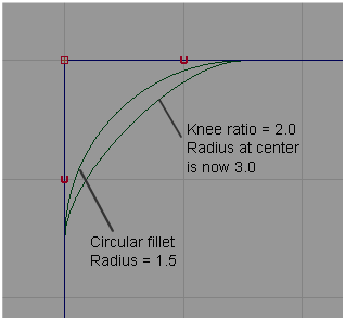

Lead Radius
The radius of the fillet where the fillet blends with the original curves.
Knee Ratio
Specify a radius at the center (or knee) of the fillet as a ratio (or multiple) of the original radius.
The resulting fillet is not truly circular, but its endpoints correspond to the endpoints of a circular fillet with the original radius.
