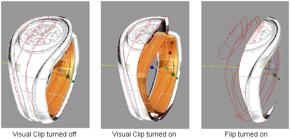

These options let you visually clip the wireframe and shaded model, leaving the sections visible.
Check this option to display only the part of the model with the sections (on one side of the sectioning plane).
Check this option to display only the part of the model that does not have sections. The sections on the invisible part are still displayed.

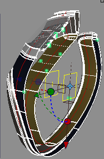

When checked on, a second clipping plane appears, and the display of surfaces/meshes is clipped to the location and direction of that second plane as well, leaving only the part of the model between the two planes visible.
The Clip Offset slider specifies the offset distance of the second clipping plane from the first.
