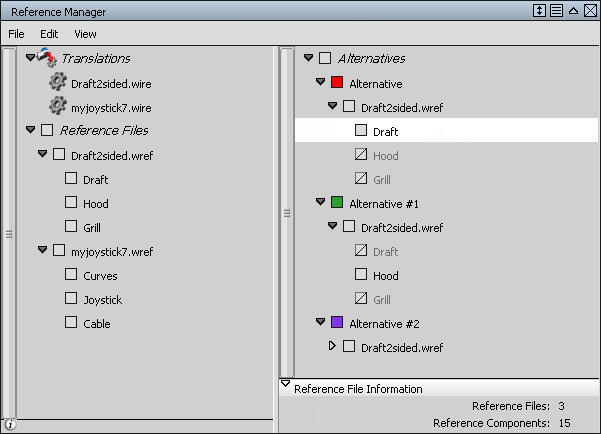

File > Reference Manager
Lets you import reference data for use in two major workflows: Importing large amounts of engineering data while maintaining interactive performance, and importing large amounts of design data and providing alternative shading and comparisons for design reviews.

Translate Reference Options
Choose File > Translate from the Reference Manager menu to open the option box.
Use project directory
If this box is checked, reference files are saved to the reference directory under the current project. If the reference directory does not exist, it is created.
If the box is unchecked, reference files are saved to the directory you specify in the Reference Directory field.
Curve Tolerance
Chordal tolerance that controls the precision with which curves are drawn after being translated. A higher value will produce smoother reference curves.
Surface Tessellator
Choose between Fast or Accurate tessellation. Fast tessellation might ignore some local details.
Surface Tolerance
Controls how accurately surfaces are triangulated.
Re-tessellate Reference Options
When you choose this tool, all selected items (individual reference files, Alternatives, layers or components) are re-tessellated according to the selected options, without having to translate the entire reference file again.
Choose Edit > Re-tessellate from the Reference Manager menu to open the option box.
Tessellator
Tolerance
Right mouse button menus
This section describes the choices from the menu that appears when you right-click various items (reference file, alternative, layer, etc) in the Reference Manager.
Translations
Remove
Deletes the name of the translated file from the Reference Manager.
Cancel
Lets you cancel an ongoing translation.
Import
Imports the reference file corresponding to this translation.
Reference Files
Visible
Toggles the visibility of the reference file. The file is visible when the check mark is displayed.
Remove File/Remove File from Alternative
Deletes the reference file from the Reference Manager.
If the file is inside an Alternative, it removes it from that Alternative only.
Show All Layers
Makes all the layers under that reference file visible.
Note:
If you right-click Reference Files at the top level and choose Show All Files, all reference files become visible.
Alternatives
Visible
Toggles the visibility of the Alternative. It is visible when the check mark is displayed.
Remove Alternative
Deletes the Alternative.
Revert Transform
Undoes all the transformations (move, scale, etc) applied to the Alternative and returns it to its original state.
Show All Files
Makes all the reference files under that Alternative visible.
Note:
If you right-click Alternatives at the top level and choose Show All Alternatives, all Alternatives become visible.
Layers
Visible
Toggles the visibility of the Layer. It is visible when the check mark is displayed.
Symmetry Original
Shows only the original reference data.
Symmetry Mirror
Shows only the mirrored reference data. It uses the symmetry plane set in Layers > Symmetry > Set Plane.
Symmetry Both
Shows both the original and mirrored reference data.
