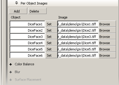

The Per Object Images section lets you create a list linking image files to objects so that different objects can use the same shader and File texture, but different image files. During rendering this list is examined. If the object is on the list, the corresponding image file is used. If the object is not on the list, the default Image (under the File Texture Parameters) is used.
If the default Image field is blank, then only the objects in the Per Object Images list will be textured. Conversely, you could turn off the file textures for specific objects by putting them in the Per Object Images list and leaving their Image fields blank. You must still assign the shader to the objects in the Per Object Images list.
A File texture that uses Per Object Images is sometimes referred to as a supertexture.
Two notable uses for this feature are Alias Paint and Convert Solid Texture. In both cases you want to create the appearance of a single texture that spans several patches. Separate image files must be used; however, by using the Per Object Images list you only need one shader. Image files in the Per Object Images list are not displayed in the Multi-lister.
Adds a blank line to the Per Object Images list.
Deletes the active (highlighted white) line in the Per Object Images list. To make a line active, click once on it.
