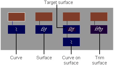

Alias keeps track of every aspect of the scene in a data structure equivalent to a graph. Curves, surfaces, groupings, transformations, components, lights, and everything else in the scene is represented by nodes in the graph. This graph is called the Scene Block Diagram.
Nodes in the graph (sometimes called DAG nodes) represent the “main” objects in the scene: curves, surfaces, curves on surface, lights, locators, and so on. Many things you can manipulate in the view windows, such as CVs, do not have their own DAG nodes. They are stored as part of an object’s internal information.

Types of nodes
Top-level objects vs components
Top-level objects are top-level nodes in the SBD hierarchy. Components are nodes grouped beneath top-level objects. The Pick > Object tool picks top-level objects. The Pick > Component tool picks objects from anywhere within the hierarchy.
