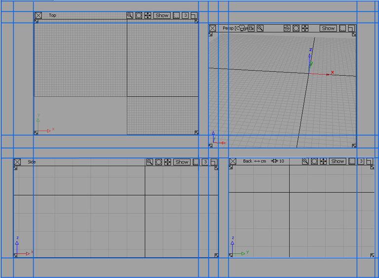

When setting up a custom layout by resizing or moving Modeling or Paint windows, a magnetic region along all windows’ edges helps you to align the windows and snap them into place. The edges around the perimeter of the Alias work space can also be used as snapping points.
In the example above, the blue lines show locations where window edges will snap.
