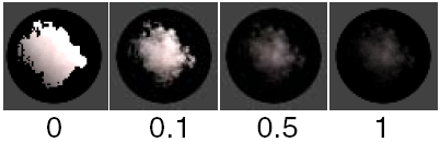

Gradually increases the transparency of the texture as the surface it is mapped to turns away from the camera. This simulates natural looking clouds. If Soft_edges is OFF, the texture is entirely opaque, and appears similar to the sFractal texture. The default setting is ON.
The range over which the texture becomes transparent. The Transp_range value controls the sharpness/softness of the edges of the cloud. The valid range is 0 to infinity. The slider range is 0 (sharp edges) to 1 (very soft edges). The default value is 0.5.

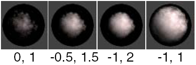

Determines how diffuse or concentrated the edge rolloff is. If the Center_thresh value is low and the Edge_thresh value is high, the texture resembles a dense cotton-ball. If the Center_thresh value is high and the Edge_thresh value is low, the texture resembles a wispy cloud. The slider range is -1 to 0 for Center_thresh and 1 to 2 for Edge_thresh. The default value is 0 for Center_thresh and 1 for Edge_thresh.

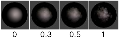

Controls the strength of the fractal noise used to generate the sCloud texture. The valid/slider range is 0 (no noise) to 1 (strong noise). The default value is 1.

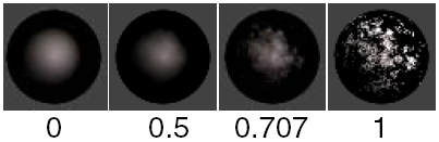

Controls the frequency of the fractal noise used to generate the sCloud texture. The slider range is 0 (low frequency) to 1 (high frequency). The default value is 0.707.
