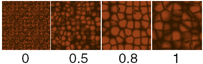

The size of individual cells. The Cell Size value effectively scales the entire texture. The valid range is 0 to infinity. The slider range is 0 to 1. The default value is 0.5.

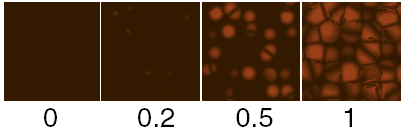

Controls the spacing of cells in the texture. The valid range is 0 to infinity. The slider range is 0 to 1 (fully packed). The default value is 1.

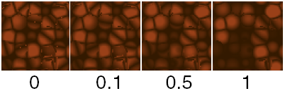

Randomizes the Cell Color intensity. (The Threshold value also influences the Cell Color intensity.) The valid range is 0 to infinity. The slider range is 0 (all cells have the same intensity) to 1 (cell intensity is entirely random). The default value is 0.1.

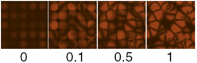

Randomizes cell position. The valid range is 0 to infinity. The slider range is 0 (cells are arranged in a regular 3D lattice) to 1 (cell location is entirely random). The default value is 0.5.

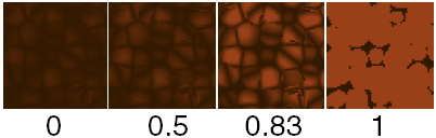

Controls how much the Cell Color and Crease Color mix into each other. The valid range is 0 to infinity. The slider range is 0 to 1 (no mixing, cells appear as solid color dots). The default value is 0.83.
