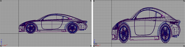

View > Set Non Proportional View
Scales the view independently along the horizontal and vertical axes, in orthographic windows.
This results in the model appearing squished or stretched, which may help reveal curvature problems.
