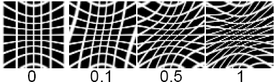

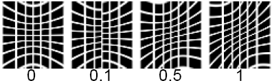

Shears the Source texture in the U direction. For example, horizontal stripes will resemble a barber pole. The slider range is -10 to 10. The default value is 0.
Shears the Source texture in the V direction. For example, concentric lines at the poles will spiral inward. The slider range is -10 to 10. The default value is 0.

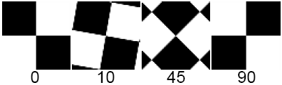

The angle (in degrees) the texture map is rotated on the surface. The slider range is 0 to 360. The default value is 0 (no rotation).

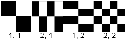

The number of times the texture is repeated within the coverage area along the surface’s U and V parametric directions. If Urepeat value or Vrepeat value are greater than 1, the texture will be repeated several times within the coverage area, but the size of each instance of the texture will be smaller than the default size. Similarly, if the Urepeat value or the Vrepeat value are less than 1, only a portion of the texture will be mapped to the surface. The slider range is 1 to 10. The default value for most textures is 1.

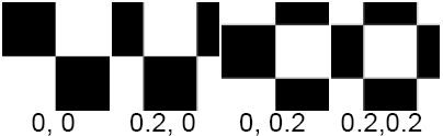

Offsets the texture pattern (without actually moving the texture itself) along the surface’s U and V parametric directions. Adjust the Uoffset and Voffset values to fine-tune the placement of a pattern on a surface. The slider range is 0 (no offset) to 1. The default value is 0.

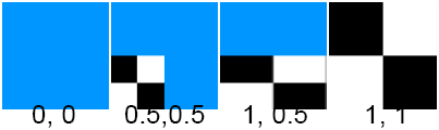

The fraction of the surface covered by the texture along the surface’s U and V parametric directions. For example, if the Ucoverage and Vcoverage values are both 0.5, the texture will cover half of the surface in the U direction and half of the surface in the V direction, or one quarter of the total surface. Areas outside of the texture coverage area have a non-texture mapped parameter value as indicated in the shader’s Control Window (for example, the shader color). The slider range is 0 to 1. The default value is 1.

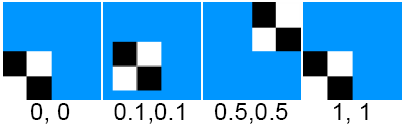

Moves the texture coverage area along the surface’s U and V parametric directions. Effectively, the Utranslate and Vtranslate values determine where the texture map will be located on the surface. The slider range is 0 to 1. The default setting is 0.
