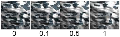

A scaling factor applied to all values in the texture about the texture’s average value. The valid range is 0 to infinity. The slider range is 0 to 1. The default value is 1.

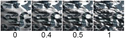

The roughness of the snow element of the texture. The valid/slider range is 0 (perfectly smooth snow) to 1 (extremely rough snow). The default value is 0.4.

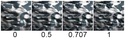

The roughness of the rock element of the texture. The valid/slider range is 0 (perfectly smooth rock) to 1 (extremely rough rock). The default value is 0.707.

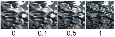

The raggedness of the rock/snow boundary. The valid/slider range is 0 (perfectly smooth rock/snow boundary) to 1 (extremely rough rock/snow boundary). The default value is 1.

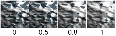

The level (altitude) of the transition between rock and snow. The valid range is 0 to infinity. The slider range is 0 to 1. The default value is 0.5.

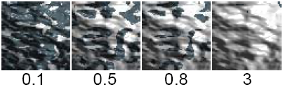

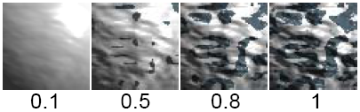

The suddenness with which snow no longer sticks to the mountain. The valid range is 0 to infinity. The slider range is 0 to 1. The default value is 2.
The maximum angle (expressed as a decimal value) over which snow will not stick to the mountain. For example, where the slope exceeds the Snow_max_slope value, it would be bare rock. The valid range is 0 to infinity. The slider range is 0 to 3. The default value is 0.8.

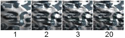

The maximum number of iterations used to calculate the fractal pattern, which controls how fine grained the fractal pattern is. The valid/slider range is 0 to 40. The default value is 20.
