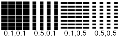

The width of the grid lines in the U and V parametric directions. The valid range is 0 to 1. The slider range is 0 to 0.5. The default value is 0.1.

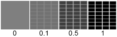

The contrast between the Line Color and the Filler Color. The valid/slider range is 0 (the two colors are averaged over the entire texture) to 1. The default value is 1.
