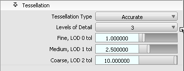

You can choose between three different tessellators:
Fast – uses the same tessellator as Hardware Shade with the Fast option selected. This is the default. Command-line equivalent: -to.
Accurate – uses the same tessellator as Hardware Shade with the Accurate option selected. Command-line equivalent: -ta. (This replaces the old AG tessellator.)
Current – this should give you the same tessellation as in Hardware Shade when Show Triangles is on (this option appears when Quality is set to User defined). Command-line equivalent: -td.
This option applies to Fast and Accurate tessellation modes only. Command-line equivalent: -t <tol> (where tol value is expressed in centimeters).
This option applies to Fast and Accurate tessellation modes only. It indicates the number of tessellations that will be saved in the JT file (1, 2, or 3). The default is 1.
Labels can be assigned to the different LODs (tessellations) and appear in the option window next to the sliders.
Only the first 15 characters of the label names appear in the option window, although all are saved in the JT file. Allowed characters are letters (upper and lower case), numbers, underscore ("_") and white spaces.
Use one of the following methods to set labels:
For example: ALIAS_JT_LOD0_LABEL=Fine
(ui-symbol "mo_eai_tess_lod0_label" "Fine") (ui-symbol "mo_eai_tess_lod1_label" "Medium") (ui-symbol "mo_eai_tess_lod2_label" "Coarse")
