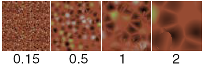

The size of individual cells. The Cell Size value effectively scales the entire texture. The valid range is 0 to infinity. The slider range is 0 to 1. The default value is 0.15.

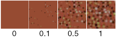

Controls the spacing of cells in the texture. The valid range is 0 to infinity. The slider range is 0 to 1 (fully packed). The default value is 1.

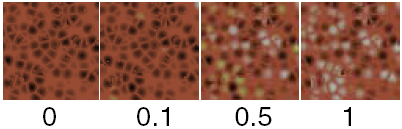

Determines which of the three colors is the dominant color. The valid/slider range is 0 (Color1 is dominant) to 1 (Color3 is dominant). The default value is 0.5 (Color2 is dominant).

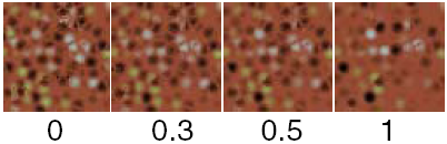

Randomizes the cell color intensity. (The Threshold value also influences the cell color intensity.) The valid range is 0 to infinity. The slider range is 0 (all cells have the same intensity) to 1 (cell intensity is entirely random). The default value is 0.3.

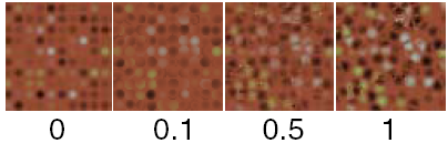

Randomizes cell position. The valid range is 0 to infinity. The slider range is 0 (cells are arranged in a regular 3D lattice) to 1 (cell location is entirely random). The default value is 1.

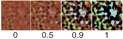

Controls how much cell colors and filler color mix into each other. The valid range is 0 to infinity. The slider range is 0 to 1 (no mixing, cells appear as solid color dots). The default value is 0.5.
