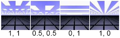

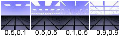

The Light Placement parameters control the size and placement of the simulated fluorescent lights in the environment. These “lights” produce reflections in surfaces, but they do not actually illuminate surfaces.
The width and depth of each light. These parameters also determine spacing between lights. The valid/slider range is 0 to 1. The default Width value is 0.5 and the default Depth value is 0.1.
The number of lights per unit length. The valid/slider range is 0 to 1. The default value is 1.
The light displacement. The slider range is 0 to 1. The default value is 0.

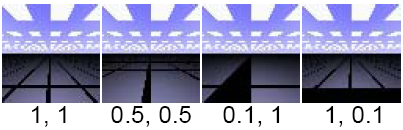

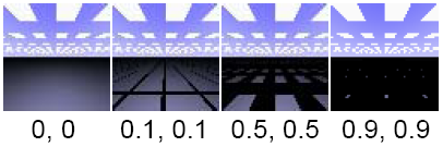

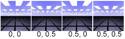

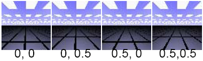

The Grid Placement parameters control the size and placement of the floor’s grid.
The width and depth of the grid lines. These parameters also determine the spacing between grid lines. The valid/slider range is 0 to 1. The default value is 0.1.
The number of grid cells per unit length. The valid/slider range is 0 to 1. The default value is 1.
The grid displacement. The slider range is 0 to 1. The default value is 0.
