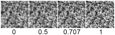

Controls the frequency of the fractal pattern. The valid/slider range is 0 (low frequency) to 1 (high frequency). The default value is 0.707.

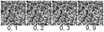

The minimum and maximum number of iterations used to calculate the fractal pattern. These parameters control how fine grained the fractal pattern is. The valid range is 0 to 100. The slider range is 0 to 25. The default value is 0 for Level_min and 9 for Level_max.
If both Level_min and Level_max are high (close to 100) rendering will take a long time. If you want to make the fractal pattern more finely grained, lower the Blurmult or Amult value instead.
