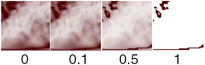

The thickness or width of the veins. The slider range is 0 to 1. The default value is 0.1.

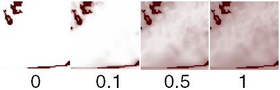

Controls the amount that the Vein_color blends into the Filler_color. (The Contrast value also affects how the two colors blend together.) The slider range is 0 (no blending) to 1 (smooth blending). The default value is 0.5.

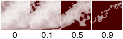

The contrast between the Vein_color and Filler_color. The slider range is 0 to 1. The default value is 0.5.

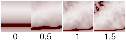

A scaling factor applied to all values in the fractal noise about the average value. The valid range is 0 to infinity. The slider range is 0 (no noise) to 1 (strong noise). The default value is 1.5.

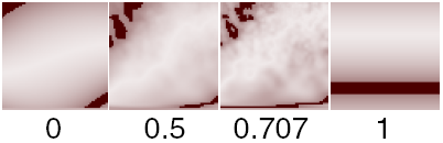

Controls the frequency of the fractal noise. The valid slider range is 0 (low frequency) to 1 (high frequency). The default value is 0.707.
