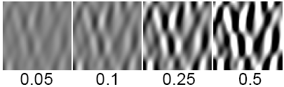

Scales the height of the waves. The valid range is 0 to infinity. The slider range is 0 to 1. The default value is 0.05.

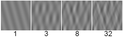

Controls the distance between primary waves. The higher the Frequency value, the shorter the distance. The valid range is 0 to infinity. The slider range is 0 to 20. The default value is 4.

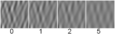

Controls the distance between any secondary waves that ride on top of the primary waves (for example, white caps). The valid range is 0 to infinity. The slider range is 0 to 1. The default value is 0.125.

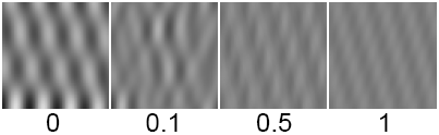

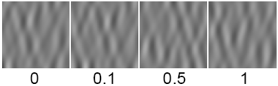

Controls the intensity of any secondary waves. The valid range is 0 to infinity. The slider range is 0 to 5. The default value is 2.

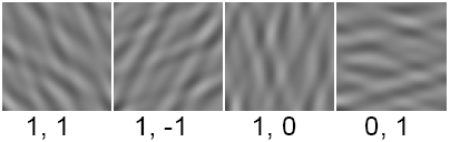

The strength of wind in the U and V directions (which determines the overall direction of the linear wave pattern). The slider range is -1 to 1. The default value for Wind_u is 1. The default value for Wind_v is 0.

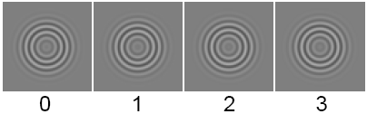

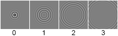

Controls the appearance of ripples over time. For example, if you relate the ripple effect to that of a water droplet falling into a glass of still water, at time 0 there is no ripple; the droplet has not touched the surface of the water yet. As the time parameter increases to a value greater than 0, the droplet has fallen onto the water surface and the ripple wave effect simulates the effect on the water in the glass at that point in time. When time has reached a value of 1, the effect of the droplet on the water surface is nearly complete and the water in the glass becomes still again.
To simulate moving water ripples, animate the Ripple_time value. The ripples will move as this value increases. The actual speed of the ripples is determined by the Group_velocity value and the rate at which you animate the Ripple_time value.

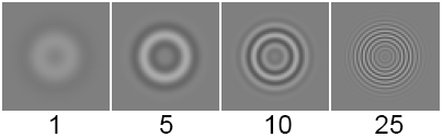

Controls the distance between individual ripples. The higher the Frequency value, the shorter the distance. The valid range is 0 to infinity. The slider range is 0 to 20. The default value is 25.

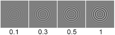

Scales the height of the ripples. The valid range is 0 to infinity. The slider range is 0 to 1. The default value is 0.05.

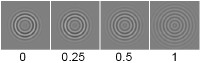

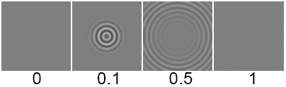

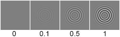

The mass of the droplet that starts the water ripples. (Imagine a water droplet falling into a glass of still water.) A Drop_size value of 0, produces no ripple effect because the droplet has no mass. As the Drop_size value increases, the mass of the drop increases, causing a greater ripple effect on the water surface. The valid range is 0 to infinity. The slider range is 0 to 1. The default value is 0.3.

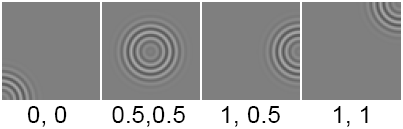

The location of the center of the ripples along the U and V parametric directions. The slider range is 0 to 1. The default value is 0.5.
The speed of the primary ripple. The valid range is 0 to infinity. The slider range is 0 to 10. The default value is 1.
The speed of sub-ripples. The valid range is 0 to infinity. The slider range is 0 to 10. The default value is 2.5.

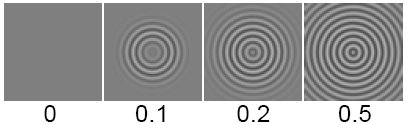

Determines the degree of effect that a droplet will have on a still water surface at time 0. A concentric ripple starts as a point of disturbance in parameter space (defined by the U_origin and V_origin values) when the Ripple_time value is 0. The size of the disturbance at time 0 is determined by the Spread_start value. The greater the Spread_start value, the greater the effect of the disturbance at time 0. The valid range is 0 to infinity. The slider range is 0 to 1. The default value is 0.005.
The rate at which the primary ripple breaks up into sub-ripples. (As a ripple expands outward, it breaks up into sub-ripples.) The valid range is 0 to infinity. The slider range is 0 to 1. The default value is 0.3.

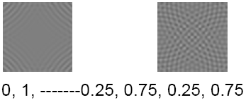

The Ripple Reflections parameters define an imaginary bounding box that ripples can reflect off. This effect, however, is nine times slower than if there is no reflecting bounding box.
Activates an imaginary reflective bounding box. The default setting is OFF.
Defines the bounding box in the U and V parametric directions. If Reflect_bound. is OFF, these parameters have no effect. The slider range is 0 to 1. The default value for Umax and Vmax is 1; the default value for Umin and Vmin is 0.

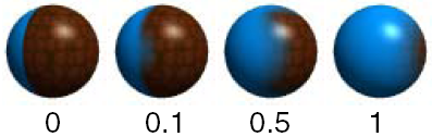

Gradually blends the texture into the (unmapped) value of the shader parameter being mapped. The blend region is defined by the boundaries of the Texture Placement Object. For example, if a Leather texture is bump mapped onto a surface, and Blend is greater than zero, the bump will gradually diminish as it reaches the boundaries of the Texture Placement Object. If Blend is set to 0, the texture ends abruptly at the boundaries defined by the Texture Placement Object. The slider range is 0 (no blend) to 1 (very gradual blend). The default setting is 0.
Blend works best if Wrap is OFF. If Wrap is ON, the texture will blend into the (unmapped) value of the shader parameter being mapped at the boundary of the Texture Placement Object and repeat infinitely as the texture is repeated.

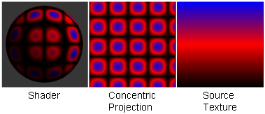

| CONCENTRIC | Projects a random vertical slice of the texture from the center to the outside edge of each voxel. A voxel is a volume element (a cube). A certain amount of 3D space contains several voxels. The size of individual voxels is based on the size of the Texture Placement Object. A surface that has a CONCENTRIC Projection texture mapped to it appears to be carved out of a three-dimensional array of cubes, where the color of each cube in the array varies from the cube’s center to its edge. For example, try using a Ramp as the Source Texture, and scale the Texture Placement Object very small.![]() |

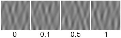

A scaling factor applied to all values in the fractal noise about the average value, in the texture’s X and Y directions. The Projection texture is rendered more quickly if the Xamplitude and Yamplitude values are both 0.
The valid range is 0 to infinity. The slider range is 0 (no noise) to 1 (strong noise). The default value is 0.

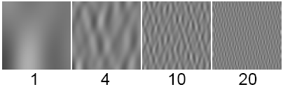

Controls the frequency of the fractal noise. The valid/slider range is 0 (low frequency) to 1 (high frequency). The default value is 0.3.
Determines how wavy the texture is in the X, Y, and Z directions. These parameters represent the scale of the fundamental frequency of the fractal used to generate the texture. The valid range is 0 to infinity. The slider range is 0 to 20. The default value is 1.
