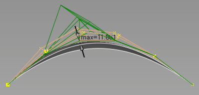

Improves the smoothness of surfaces and curves by harmonizing CV distances and simultaneously minimizing angles/kinks inside the hulls.

Check Deviation
- Displays and updates the maximum deviation between the input and smoothed object after each Smooth.
