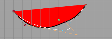

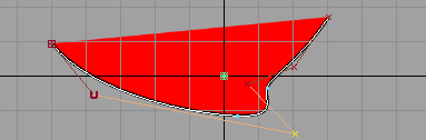

The Interactive check box controls how your shape shows changes when you modify the curve(s).
Modifies only the curve. The shape remains unchanged.
When the mouse button is released, the shape snaps to the new curve. If you do not like the new shape, press

The whole shape updates interactively as you modify the shape’s curves.

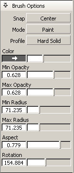

The Brush Options are visible on the Paint Panel when you have a tool from the Paint palette selected, or a tool from the Sketch#2 shelf selected.
This section displays frequently modified attributes of a brush.

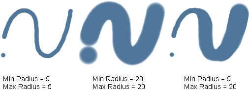

In the Paint Panel or Brush Options box, adjust the Min Radius and Max Radius sliders or enter values in the Min Radius and Max Radius fields. These values are measured in pixels (of the sketch image plane). The maximum brush size is 255. Max Radius is displayed in a solid line and Min Radius is displayed in a dotted line.

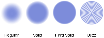

Controls the softness or hardness of the brush stamp edges. Select one of Regular, Solid, Hard Solid, or Buzz from the pop-up menu to obtain the following brush profiles.
To use a brush profile you have customized, select the Custom menu item. Double-click any brush icon in the Sketch#2 shelf to open the brush editor for customization.

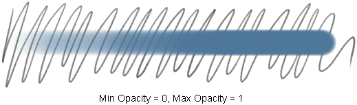

You can make the brush opacity change based on how hard you press the stylus on your tablet. The Min Opacity is the minimum opacity for the brush (when you press lightly with the stylus) and the Max Opacity is the maximum opacity for the brush (when you press hard with the stylus). If you do not want the opacity to vary with stylus pressure on the tablet, set the Min Opacity and the Max Opacity to the same value.
The size of a brush is based on its Min Radius (when you press lightly with the stylus) and its Max Radius (when you press hard with the stylus). If you do not want the size to vary with stylus pressure on the tablet, set the Min Radius and the Max Radius to the same value. Small brushes are more responsive than large brushes.
