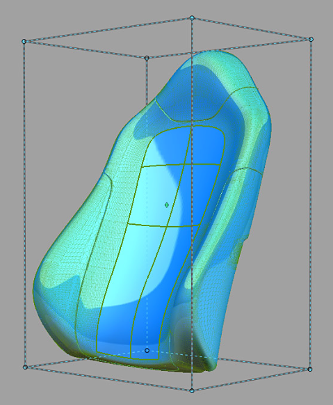

Alias provides a box-shaped manipulator called a lattice to enable global modifications to the model.
The lattice box always starts in disengaged mode, and is initialized as a bounding box enclosing the selected geometry.
The lattice can be modified and refined from its initial box shape without affecting the underlying targets (surfaces or meshes) as long as the lattice is disengaged. After developing a lattice that provides the shape and detail required, engage the lattice. Subsequent changes to the lattice will modify the targets.

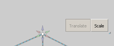

The points on the lattice are not CVs — they are manipulator handles. They can be moved by using only the functions offered by the lattice rig tool.
If there is an active construction plane, a new lattice respects the construction plane and aligns to it. Also, the manipulators of the lattice points independently respect the construction plane. That means that, no matter where or how the lattice is created, the manipulators respect the current active construction plane.

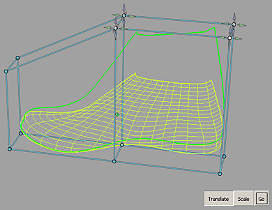

The geometry being modified is represented by a proxy. A proxy is a lightweight wireframe representation of the targets being deformed by an engaged lattice. The proxy interactively updates while you modify the engaged lattice to show what the targets look like after deformation (see the following image). Meanwhile, the targets remain unchanged until you release the mouse button (when Auto Update option is ON) or when you click GO (when Auto Update is OFF).

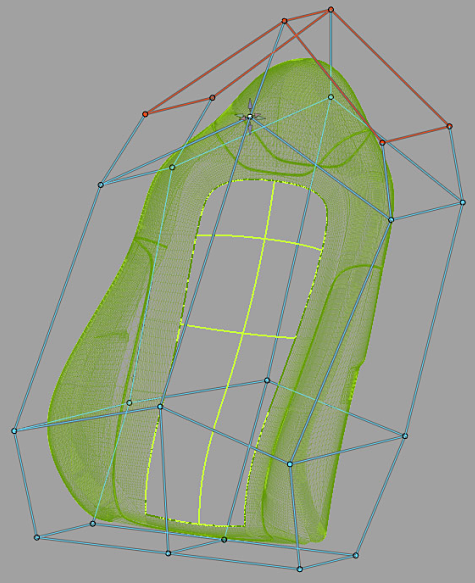

All modifications made to the engaged lattice influence the shape of the targets enclosed by the lattice.
All the geometry not enclosed by the lattice are constrained. To show that these areas have been constrained, the lattice points and edges that intersect the geometry are shown in red.

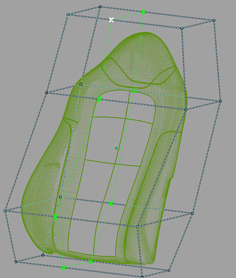

When the lattice is in disengaged mode, its lines are drawn as dashed lines, and changing the lattice does not change the target geometry. To engage the lattice, click the tool; to disengage, click the tool again. The tool works as a toggle between the two modes.
The split tool adds new lattice segments like a belt wrapped around the lattice box. The split tool is only accessible while in disengaged mode. To split an edge of the lattice, click this tool, and then click the edge that you want to split. The split is perpendicular to the edge you have selected.
