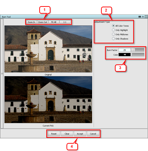

Paint Edit > Color Correction > Burn
Darkens an image layer.
Use the Burn window to darken an image layer. Changes happen only to the current layer.
This tool is based on the traditional photography technique of increasing the exposure to darken areas on the film.
Burn darkens areas of an image (highlights, shadows, midtones, or all tones) as if paint of the selected color was added to them.
The top image shows the original state of your image layer. The bottom image shows the current state of your changes. Click and drag in either window to pan large images.
Note: No change is applied to the actual layer until you commit it. The editor allows you to experiment.
1 Use the buttons at the top to change the magnification of the image layer in the editor.
2 Choose an Adjustment Type. The Adjustment Type determines which range of color values is modified. You can modify:
3 Adjust the Burn Factor and Color sliders to update the image on the bottom, for comparison with the original image at the top. The smaller the values, the finer the adjustment.
To change the color of the “paint”, click the color swatch to open the color editor.
4 Use the buttons at the bottom to commit or discard your changes:
  • Reset restores the options default settings.
  • Clear reverts the image to its appearance on entering the editor.
  • Accept leaves the editor and applies the changes to the image layer.
  • Cancel leaves the editor without saving any changes.
