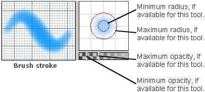

The radius of the brush (measured in pixels) when you press the stylus lightly against the tablet. The valid range is 0 - 255. See Set brush size, shape, and profile.
The radius of the brush (measured in pixels) when you press the stylus strongly against the tablet. The valid range is 0 - 255. See Set brush size, shape, and profile.
Controls how see-through the paint applied by the brush is when you press the stylus lightly against the tablet. If Min Opacity is less than 1, and you sketch several times in the same spot, the paint builds up and becomes more opaque. The valid range is 0 (fully transparent) to 1 (fully opaque). See Set brush and paint opacity.
Controls how see-through the paint applied by the brush is when you press the stylus strongly against the tablet. If Max Opacity is less than 1, and you sketch several times in the same spot, the paint builds up and becomes more opaque. The valid range is 0 (fully transparent) to 1 (fully opaque). See Set brush and paint opacity.
