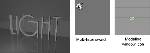

Creates a point light that provides a gentle omni-directional illumination.
Ambient lights are like point lights except that only a portion of the illumination emanates from the point. The remainder comes from all directions and lights all objects uniformly.
You can open the Ambient Light Options using the Ambient light tool.

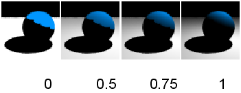

The proportion of directional light to omnidirectional (ambient) light. The slider range is 0 (light comes from all directions) to 1 (light comes only from the position of the light). The default value is 0.5.
