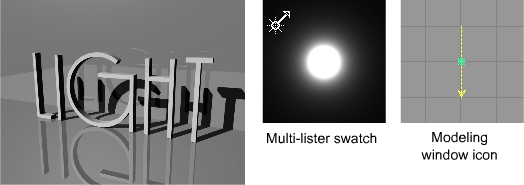

Creates a directional light that illuminates in one direction without having an obvious source of light in the scene.
Directional lights have color, intensity, and direction, but no obvious source in the scene. Use directional lights to simulate very distant light sources. For example, the sun can be considered a directional light since it is far enough away that light rays reaching the earth are effectively parallel. Directional lights do not decay with distance.
Because directional lights only have a direction, their location in a scene is unimportant. This also means that during raytracing they can cast shadows on objects behind their apparent location in a scene.
The Directional Light Options can be opened using the Directional light tool.
