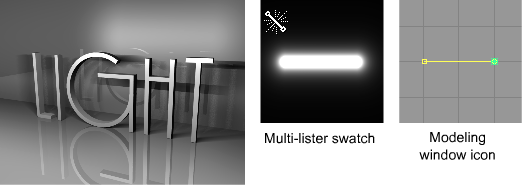

Creates a fluorescent tube-like light.
Linear lights are one-dimensional lines of light like fluorescent tubes. A linear light is initially two units long. Use Transform > Scale
to re-size a linear light.
