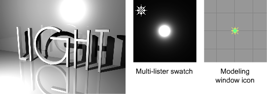

Creates a point light that illuminates evenly in all directions.
Point lights are like incandescent light bulbs — they throw light evenly in all directions.
The Point Light Options can be opened using the Point light tool.
