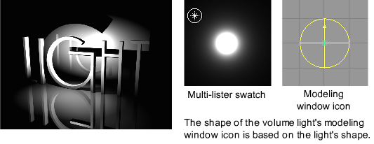

Creates a geometrical volume that illuminates objects contained within the volume without illuminating objects outside the volume.
Volume lights define a closed volume within which objects are illuminated; nothing outside the volume is illuminated by the volume light.
Within the volume, the direction and intensity can vary with many different parameters. A volume light is a convenient way to “link” a light spatially, instead of by object. One main use of the volume light is as an emitter of forces or particles. Volume lights are also useful for removing hot spots or glare by using a negative Intensity value.

Defines the shape of the volume light as either a BOX, SPHERE, CYLINDER, CONE, or TORUS. The default setting is SPHERE.
You can also use the Transform tools to position or reshape a volume light. Apply the Transform to the light icon in the modeling window or to the DAG node above the light in the SBD window.
