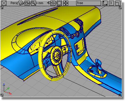

Surface Edit > Orientation > Set Surface Orientation
Orients surfaces toward or away from the camera.
This tool lets you do the bulk of your orientation work by automatically changing the orientation of any number of surfaces at once, and shading the results (blue or yellow) for immediate feedback.
