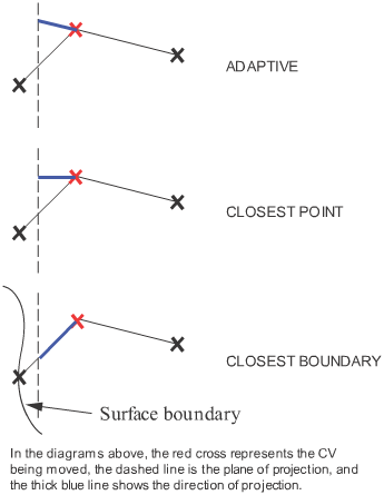

Project Vector
This option determines the direction of projection for each CV.
Adaptive – The direction of projection is along the hull line that is closest to the perpendicular of the plane.
Closest point – The direction of projection is perpendicular to the plane.
Closest boundary – The direction of projection is along the hull line toward the closest surface boundary.
