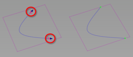

Extend
Extend a curve that does not project entirely on the patch, either automatically or manually, and continue the trim operation without leaving the tool.
Auto
When the trim fails, any curves-on-surface that are within the set Tolerance of another curve-on-surface or boundary are extended and the trim is attempted again.
Selected
A trim extend arrow appears on the curve that needs extending. Clicking the arrow snaps the end of the curve to the patch edge.

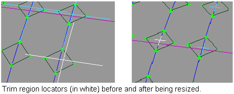

Region Selector U Size/V Size
The relative size of the trim region selectors in the U and V parametric directions on the surface. Adjust these sliders if the selectors (crosses) appear too small or too large on your model. The values range from 0.01 to 2.0.
