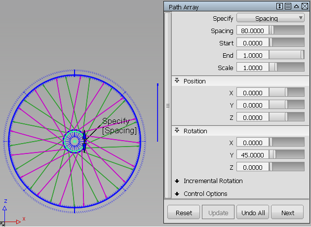

Example
In the following image, a spoke (two surfaces, shown to the right of the bicycle wheel) is duplicated and placed along a circular path curve (inner rim). The operation is repeated twice to create two sets of spokes: one rotated by 45 degrees around Y (in pink), and the other rotated by 315 degrees around Y (in green).
