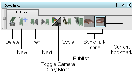

The Bookmark Lister contains the tools necessary to create, edit, delete, view and publish bookmarks.
The tools are followed by a list of icons representing your bookmarks. (There will not be any bookmarks until you create them). The current bookmark has a light blue outline. You make a bookmark current when you click it to view it.

Put the cursor over a tool to see its name.
Remove the selected bookmark(s) from the list.

Create a new bookmark and add it to the list. The bookmark includes model orientation (camera view), shading attributes, and sketched annotations (drawn using tools from the Paint palette).
Double-clicking on the New Bookmark tool opens its option box, where you can set the following option:
If checked, the bookmark also remembers which objects, layers, and categories are visible and invisible.
View the previous bookmark in the list.
View the next bookmark in the list.
Display bookmarks either with the camera view only, or with both the view and display attributes (default).

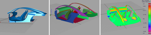

Bookmarks capture the current camera view and settings as well as a selection of display attributes and diagnostic display values.
Clicking this button toggles on the “camera-only mode”. In this mode, the current display (diagnostic shading, hardware shading, and so on) does not change when a bookmark is selected. Only the view (camera) is set. Clicking the button again toggles off “camera-only mode”.
Three bookmarked views with Toggle Camera Only turned Off
After viewing the first bookmark, Toggle Camera Only is turned On. Display attributes remain the same when viewing the other two bookmarks.

View the bookmarks in a slide show fashion. The slide show starts at the current bookmark and displays the following bookmarks in order, all the way to the end of the shelf. It then loops around to the first bookmark.

Save one or several bookmarked view(s) as image file(s) on your local disk.
