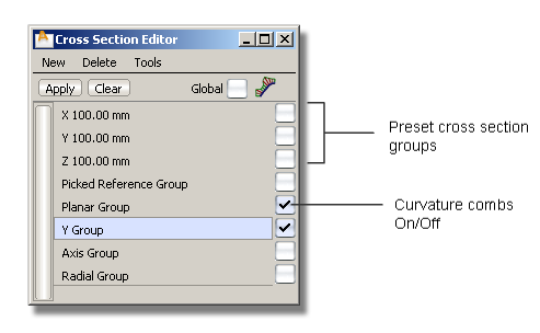

The editor contains three preset cross-section groups, perpendicular to the X, Y, and Z axes at 100 mm intervals.
To the right of each cross-section group’s name is a check box that lets you view or hide curvature combs on the cross-sections when the objects are selected.

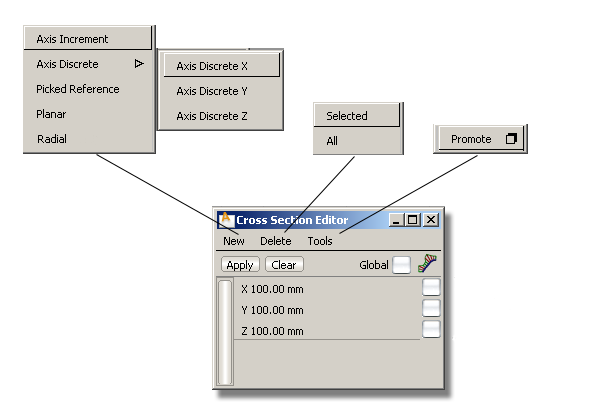

The editor includes the following menus:
This menu lets you define sections in five different ways: Axis Increment, Axis Discrete (choice of X, Y or Z), Picked Reference, Planar, or Radial.
Choosing one of these options creates the cross section group, applies the cross section group to the selected geometry (or all geometry if Global is turned on) and opens the appropriate option window. See Cross Section Types below for details.
Delete the Selected cross-section group(s) only, or All cross-section groups (except the preset groups which cannot be deleted).
The only choice is to Promote the selected cross-section groups on the selected objects, to section data geometry. You can also pick individual sections after you enter the Promote tool.
